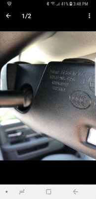

Figured I would post a picture of my Smart Beam (auto high beam) mirror just for reference in case people are considering installing them. This is what they look like. they are very often listed incorrectly on eBay and on other websites so it's good to know what it should look like.20180801_194322.jpeg

this is mine on ebay says to work on 13 and on sites on the internet it says it is not compatible

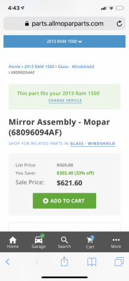

I considered it but says 05-13 only in the details?

When I bought mine the were interchangeable between 1500, 2500 and 3500.

To the best of my knowledge the auto high beam and rain sensing wipers are standard equipment on all Laramie Limited's and Laramie Longhorns so this mirror should have the Smartbeam option.

Although it did take them 3 separate time before they got me one with the smart beam as described. It's better if the can get you a picture of the mirror or vert least the actual part number. Persistence is the name of the game. Mine was only 60.00
