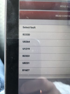

sorry I do not want to bring my problems but someone of you could help me with what I did my wiper fluid stopped working do not drip the water and do not move in at good time get to disable it in these rainy days every day for my state
Hi Cesar, it sounds like you may have accidentally changed a setting related to the wiper system. You need to examine the log file in AlphaODB and look at each change that you made to find the one that caused the problem.

these are the error codes that I have

Those look like you enabled (or attempted to test using the app) rear window and headlamp wipers, which a RAM would not have.

B233D-13-FRONT/REAR WASHER MOTOR (+) CONTROL - CIRCUIT OPEN or B233D-11-FRONT/REAR WASHER MOTOR (+) CONTROL - CIRCUIT SHORT TO GROUND
U0264-00-LOST COMMUNICATION WITH CAMERA MODULE - REAR
U0231-00-LOST COMMUNICATION WITH LIGHT RAIN SENSING MODULE
B16E7-11-LICENSE PLATE LAMP CONTROL-CIRCUIT SHORT TO GROUND or B16E7-15-LICENSE PLATE LAMP CONTROL-CIRCUIT SHORT TO BATTERY OR OPEN
Im not sure all of those would be triggered by stuff from AlfaOBD....did you have any other wiring/electrical issues in the truck even before using Alfa?
I'm going to agree with @chrisbh17, looks like you enabled/tested equipment that doesn't exist on your truck.

I had never had electrical problems before using alpha until I moved or enabled something by mistake my truck is a 2013 slt
