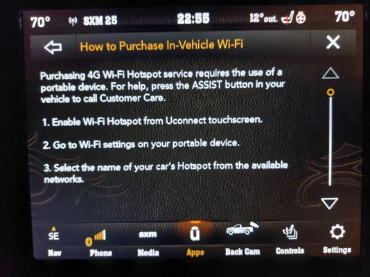

I strongly suspect that the Wi-Fi/Hotspot concept with the Uconnect is limited to using the onboard Sierra Wireless card to generate a Wi-Fi signal within the truck for use with a laptop or tablet.
I don't believe the Uconnect Wi-Fi Hotspot can be used to connect the radio to the internet via a cell phone HotSpot or other device.
Keep in mind, this is another money generation idea for Uconnect to sell a Wireless service and make money. Nothing to do with customer convenience. :cool:
I found the Uconnect Wi-Fi HotSpot in the Apps section, on the radio in my truck.
Uconnect/Apps/Wi-Fi Hotspot.

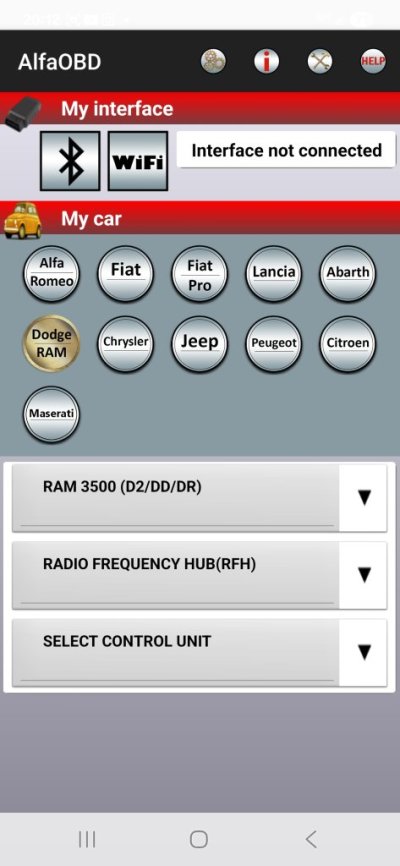

Hi all,
Has anyone come across the setting in Alpha OBD to change from Police mode to Civilian?
I know I saw this somewhere while browsing through settings. I'm just curious if it's somethin found an all 5th gen Ram trucks.

Hi all,
Its under 2013+ Radio Frequency Hub settings. It is to reverse settings from Police mode which includes things like blackout for interior lighting. Ford has similar functions for their truck/SUVs.

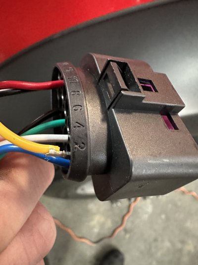

Hello everybody, I’m trying to swap to projector headlights in my 2018 5500. I enabled all the options in alfaobd but the drivers side running light still won’t work. Anyone have a fix or heard of this before?
Did you check the bulb? Swap it with the other bulb.

There led on the factory projector headlights you can’t swap the bulbs.
Oh ok, the little LED parking lights. First test power at the plug with the switch on. If you're getting power at the plug for parking lights but the LEDs aren't coming on then they are faulty. I haven't heard of anyone trying to replace them or repair the circuit but that usually is not serviceable.
If you bought the lights used, now you know why they were selling them.
We're talking about these, correct?
My bad I was talking about the strip under the headlight but that light is also not turning on. I’ll try to attach a picture
