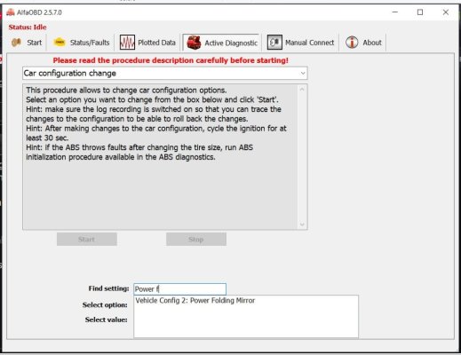

2010 Ram 2500 Laramie - I am trying to add power folding mirrors. I have the correct mirrors, switch and door modules. Activated power fold in alfa. I lost almost all functions from the driver switch. Power windows front only, defrost, memory, mirror adjustment, etc. do not work. When I press the power fold button, only the drivers side folds. i am also getting a communication error from the bcm to both door modules.
I suspect the modules I have are unable to communicate with the bcm.
I am fairly confident that I read a post of someone that enabled power fold on the 2010-2012 models.
Can anyone confirm?
Thanks

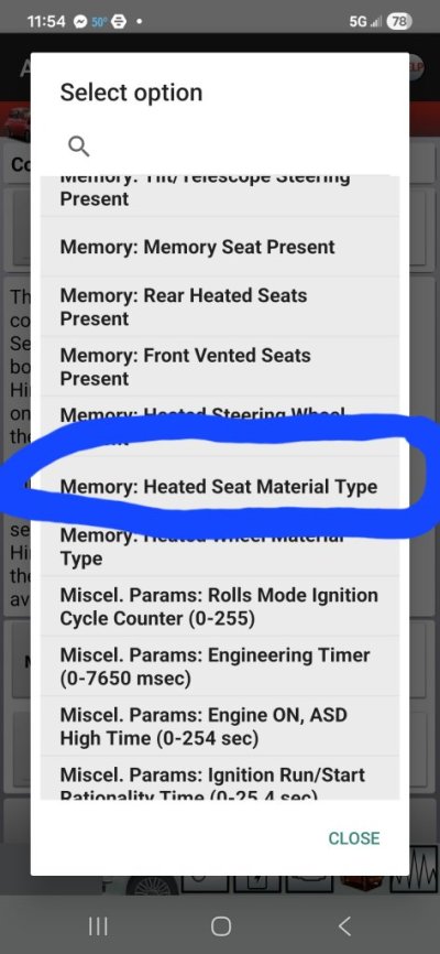

I did all the same, options in my 18, 2500. An option i just saw and need to look into is the seat warmers. I have some heavy duty seat covers and can hardly feel the heat anymore. I'm gonna try changing it from cloth to base leather. See if i can't get a lil extra heat out of them.

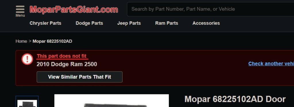

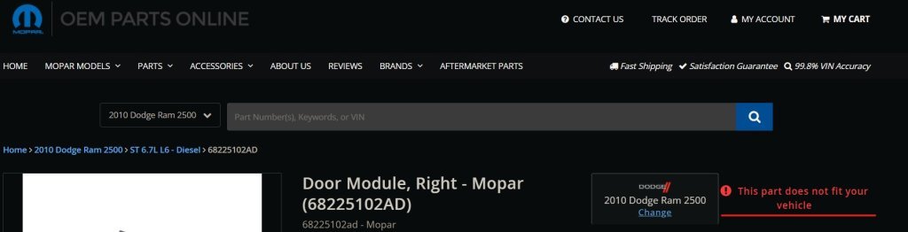

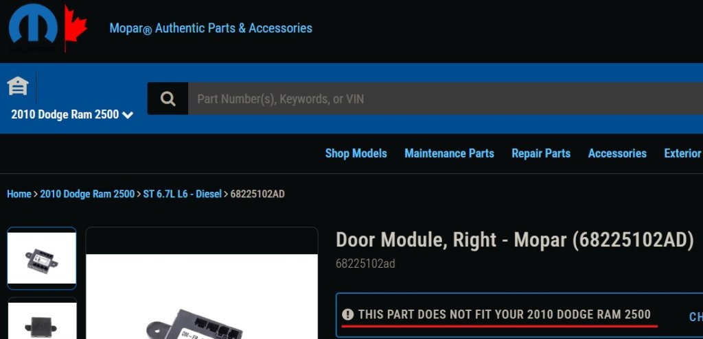

So the other door functions failed to operate after installing the new door modules or after the AlfaOBD tweaks?
Where did you determine that these door modules were suitable for your truck?
The one site that I definitely don't trust indicated 68225102 was for 2011+.
I would take the following with a grain of salt because all of the following Mopar sites may share a common database for reference, but none of them list this part as compatible with a 2010 Ram 2500 CTD.
