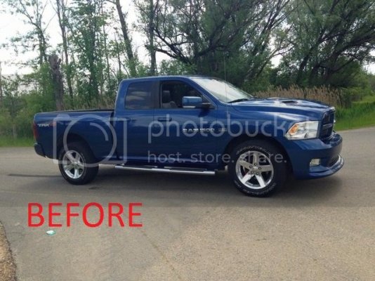

The factory front ride height on my truck from the ground to the bottom of the middle of my fender opening was 36.5" and in the rear was 39.5". (that is the same height is what the rest of the rams come from the factory ...correct?....the TRX4 would come factory in the 37.2"-37.5" range on the front correct?.
After leveling the front out it is now at 38.5" (about 2" of lift).

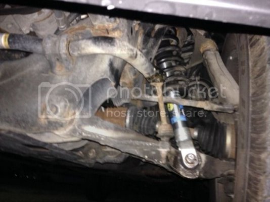

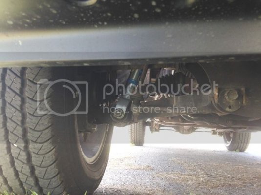

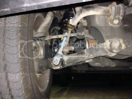

I posted a picture of my CV axles in another thread and a member responded and said that it looked like maybe my CV shafts were at to high of an angle when they should be almost straight across and he shared a picture of his ram that also has the bilsteins set at 2.1" and his axles are in fact much more straight across than mine.

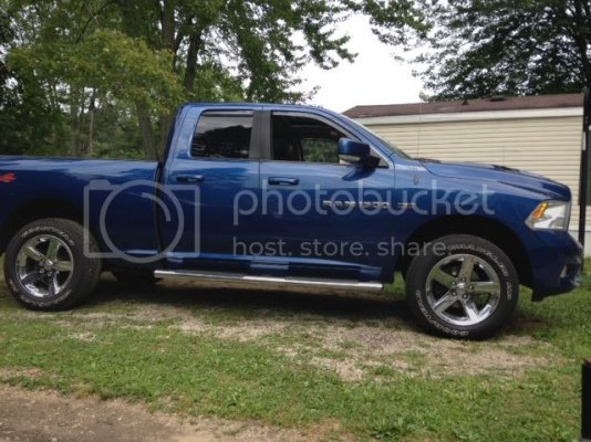

After leveling and before alignment
After leveling and after alignment (looks about the same to me)
Before level
After level

Also the truck came from Canada. Doubt that has anything to do with anything but figured I would mention it.

I think it is more a difference in angle that the pictures were taken at. To me the axles look like they are at the same angle (which they should be since the alignment point is the cam on the lower control arms that would only control the pivot point of the spindle and not the height of the lower control arm..etc..etc..).

well looking at it in person it looks the same. And there is no reason the pitch of the cv axle would have changed from an alignment. only the pitch of the outer cv joint which should have increased due to the camber being positive after leveling.
I think it is just the picture that makes it look like less of an angle. If you notice the pictures I took of it post alignment were more straight on where as the pictures of it pre alignment for from lower pointing on an upward angle.
