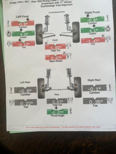

A stupid question but have to ask !
On a RAM 1500 with a Pentstar motor have the same alignment specs if it had a Hemi ?
Asking because the alignment I had a few moths ago is eating the inside of the brand new front tires with maybe 1500 on them
Thanks

Both front tires are wearing same side so IMO he used same spec both sides
Supposed to give me new tires and I assume free realignment
And I want to be sure they give me b4 and after spec sheets they did not staple the first set to my bill

T1 is how it was first aligned and killed my front tires in less the 2k :O
I wonder why ? LOL

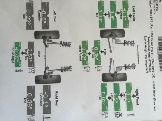

T 2 is today s alignment
also they change both front tires to new one all for no charge !
A shop that cares about their work !
So I am happy
The Tech was canned a month or 2 ago :O I wonder why ? LOL

Thank you!
I was surprised when he said the Tech screwed up :O
And they IMO went above and beyond to make it right !
I will be doing more business with them for sure
I wonder why ?
That alignment was pretty bad if it ate tires in 2K miles. When I had new tire put on had the shop check for bad wheel bearings but turned out it was just the alignment that made the AT type tires noisy going down the road, probably would have got 70K out of those tires if winter wasn't approaching.

The manager and Tech went over the whole front end !
Did a Shake Down I think they called it looking for anything loose !
So all wear items are OK
But the 1st tech just really screwed it up and he is no longer working there !
Guess he screwed up more then just my truck :O And been gone a few months
