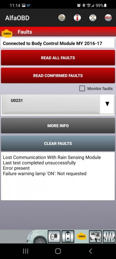

I changed the setting, but still not working. Here are the fault codes, but I have no check engine light.

Do you have the auto on rain sensing wipers?
mtnrider
Sep 25, 2014
3,542
4,311
Georgia
If it's throwing a fault for them they might have been enabled in Alfa some how? That could be throwing everything off. Getting into tricky territory without a original log though?
There is a setting for Auto Wipers, might be worth a look to see if it is enabled?

I changed a few things and After a few drive cycles, they started functioning normally. Thank you for your help!
