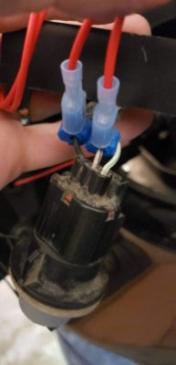

I installed the AlphaRex G2 Pro Series and had parking light out error from the start. Tried everything with AlfaOBD and several pre-made resistor setups and nothing worked. Finally got with AlphaRex via Facebook of all places and they told me what size resistors and where to install them, and after almost 3 weeks of errors and fighting it....no more errors. 50ohm resistor looped between the black wire and whichever color wire is next to it (mine was white/brown in driver side, but white/green on passenger side) and now no errors. I also have the front park/marker lights on AlfaOBD set to “no” and they work exactly as they should...or as they should have from day one. The resistors were $7/pair from Amazon. I would like to see AlphaRex just send some with every set of headlights in case people need them.

I had the same exact issue as you. I contacted Alpharex and they sent me some resistors. Fixed the light out message. I agree- they should include them with the package.

To umbighouse...Alpharex also just sent me the resistors for the same problem. My question is how did you install them? I haven’t taken the lights out to see where the small white plug on the resistor would connect.

I believe I installed then like Hukweem Bailey did. And I was also able to contact them via Facebook and they sent them to me for free. Took about a week.
