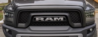

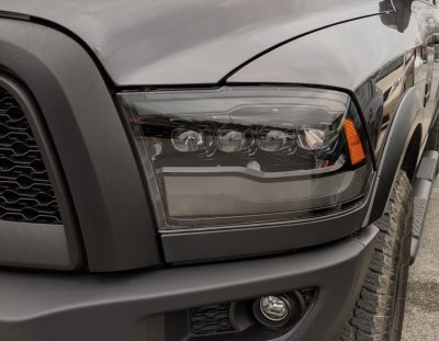

I just installed a set of Nova projectors on my '17 Rebel. Novas have integral LEDs, this is not the version that you install an aftermarket LED into. These were ordered just before Thanksgiving (clearly they walked here from China). This project took 20 minutes (I have removed my projectors before, so I already knew the gotchas). @CAG CheechDogg we were talking about this a while ago in another thread.
First impressions -
  • The build quality is good and they fit perfectly, no coercion involved.
  • The wiring adapter harness (you need to buy that if you have factory projectors) was well made and intuitive (there are no installation instructions, but plenty of good enough YouTube videos).
  • The output is pretty good when I was doing an initial adjustment in daylight, I'll know more after tomorrow night when the rain has stopped and I can play more.
  • I did not install the DRL harness, but there's instructions for that if I had wanted to.
  • Alpharex did something smart in that the vertical adjustment screw is a gear which you turn with a long #2 Philips, no need for an extra long T20 or 7mm socket. It is accessed through the same holes as the OEM headlight adjustment screw.
The Novas did NOT cause any codes to be thrown (I had my trusty AlphaOBD at the ready) and I did not install any resistors. I suspect this is because my running lights and turn signals were LED from the factory. I know that previously in this thread, @AE5548 said that his OEM running/signal lights were incandescent and his Novas caused a code. In my case, these were truly plug and play.
Here are a couple of pics after install. I'll post a few output pics at some point.
