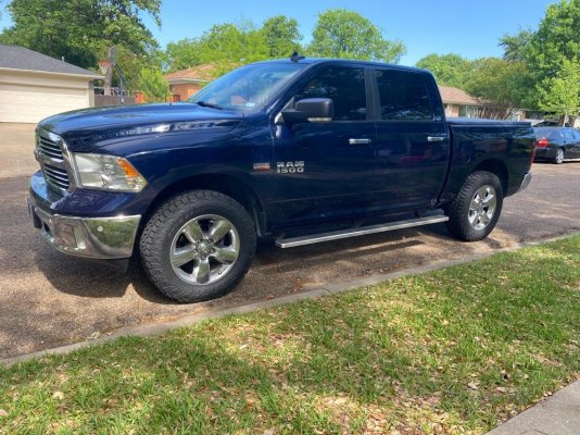

They are stock sized Yokohama 275/60/20 Wildpeak AT3. Been great so far. Smooth for an AT tire with very little road noise. If I did it again, would have gone 275/65/20 but I got a hell of a deal on these that I couldn’t pass up. All 4 for $758 installed and balanced.
Falken, not Yokohama.
mreservices
Jan 24, 2020
43
43
WV
2016 Ram Laramie 4WD
I have the same tire on my power wagon. They have been great.
Yes, I’ve been surprisingly pleased with these tires. I was going to go with the K02, But I got a great deal on these so I thought I would give them a shot. Had some issues with getting them balanced at first. Had to be road force balance but now everything is perfect. I would definitely recommend them.

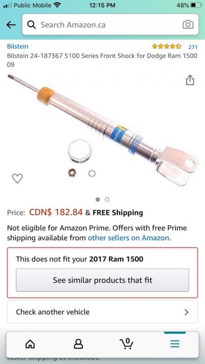

Am I stupid or is amazon stupid? Why does it say this won’t fit on my truck yet part numbers match? I ordered them anyways lol
I also paid less yesterday lol.
Those are the same skew number Bilstein 5100's that I have on my 2016 Ram 1500 Sport Crew 4X4. Amazon does that alot when it comes to fitment.
Ok cool.
They can spy on us in our homes and provide with essentially ANYTHING, however, they can’t figure automotive parts [emoji2369] lol

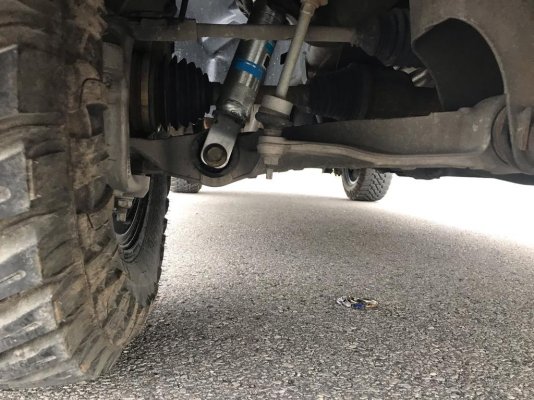

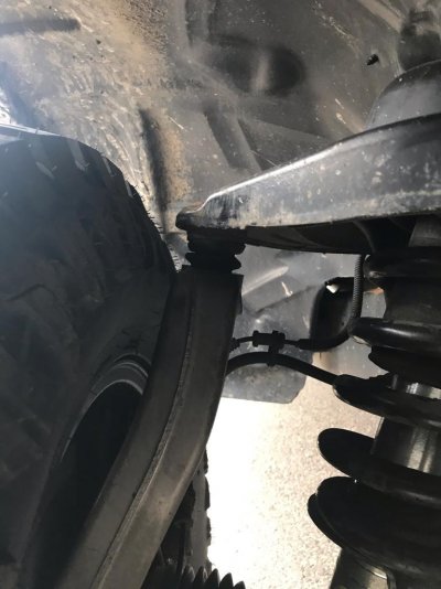

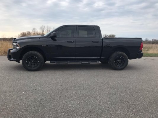

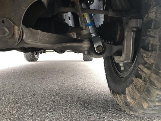

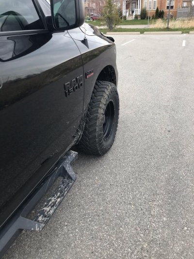

I can finally post here without a compliment or question!!!
2017 1500
2.1” in the front. Stock back
Pro comp 45 series -6 with 33x12.5x17 Atturo trail blade MT
No rub.
The CV angles look pretty darn good! I was worried.... shoulda went 2.8 lol. Maybe I’ll change it down the road.
Driving home they feel AMAZING. Not spongy, feels planted and drives like a truck should. I wouldn’t say it’s harsh tho. So far I’m quite pleased. I’ll know more obviously after driving it for some time but this is my initial assessment
Would I recommend ? Yes.

'bout time dude! Looks good

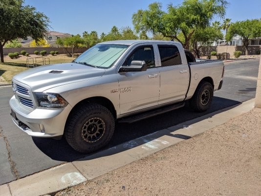

Front: Bilsteins set to 2.8", Zone UCA, MaxLinks Sway Bar 3" longer links
Rear: TufTruck 1211 springs plus TopGun 3/4" metal spacer
Rims: Method NV305 17x8.5 - 0 offset
Tires: Falken Wildpeak 35x12.5R17
That looks really good! Makes me want 17's instead of 20's

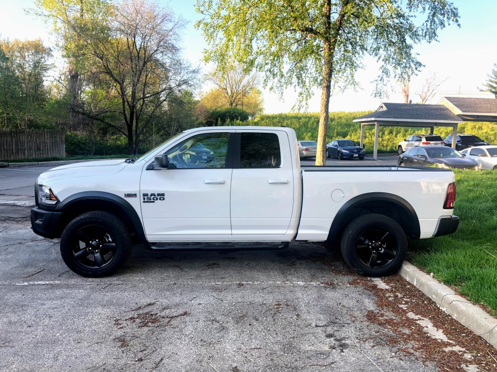

Better shot of 2.8 with mopar 1in springs in rear on stock wheels and tires.

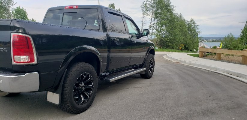

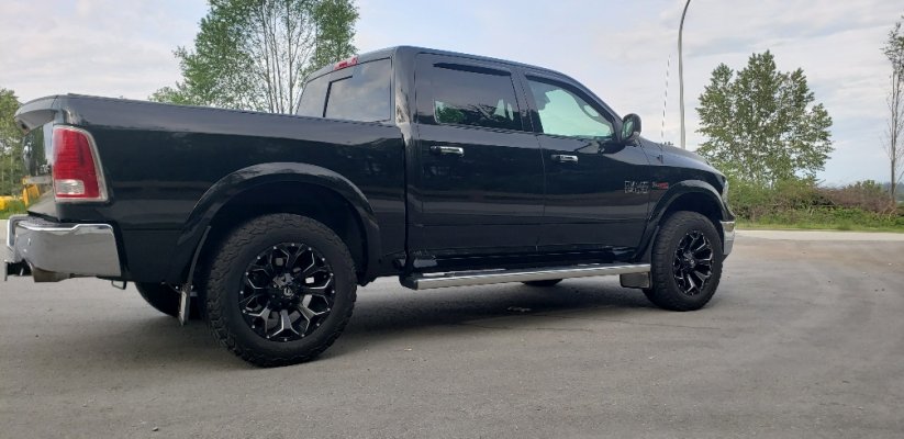

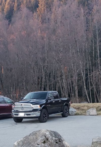

Long time lurcker, finally took the plunge! Happy to be able to finally contribute to this thread! truck is on a bit of a slope noise down in the pics. Set @ 2.8 and 1 inch Daystar spacer in rear7c4b151106eb28f882f03f931c92b1b2.jpg14ab30955da9be4cee0223cc7f2551ed.jpg258704b13c0a0c0209b3a16cef52274b.jpg
