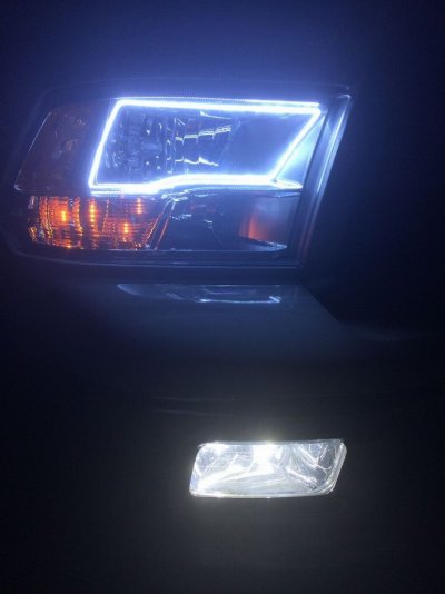

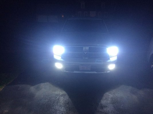

These are LEDs in the fogs from a member on the other forum..
New Angle
Fog Lights Only
Headlights and Fog Lights
