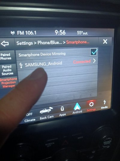

Dont know if anyone is still following this thread or having this issue, but I was.having the exact same problem and I think I figured it out. In the Ram Phone/Bluetooth menu there is another menu called the Smartphone Projection Manager. In that menu there is an option to turn "Smartphone Device Mirroring" off and on. I'm assuming mine had always been selected to be "ON" but somehow got turned off. I selected this option to be back on and sure enough Android Auto turned on immediately (because I was plugged into the truck). Hope this helps you and someone in the future.1711245506767386400799326682316.jpg17112455329974504955553270435249.jpg

That's for mirroring or casting. I don't believe you should need to enable it if.using USB cable or BT to enable AA.

Dont know if anyone is still following this thread or having this issue, but I was.having the exact same problem and I think I figured it out. In the Ram Phone/Bluetooth menu there is another menu called the Smartphone Projection Manager. In that menu there is an option to turn "Smartphone Device Mirroring" off and on. I'm assuming mine had always been selected to be "ON" but somehow got turned off. I selected this option to be back on and sure enough Android Auto turned on immediately (because I was plugged into the truck). Hope this helps you and someone in the future.View attachment 539976View attachment 539977
Thanks!!! This worked for me. I've been trying the figure this issue out forever.
