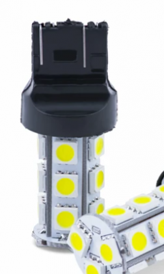

If you can't get them to work with AlfaOBD then get Syneticusa ones on Amazon. Their resistors are wired in & don't get hot like the cheap copper ones.
Error-free and bright.
