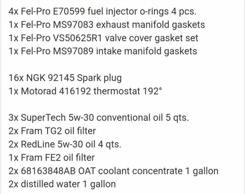

My parts list:
2015 Ram 1500 SLT 201,192 miles
Note: BONE STOCK REPAIR WITH MDS
I spent close to $6k between all these parts, assorted tools and supplies, plus tax, and shipping, etc.
I'm sure I didn't need every single part, but didn't want to leave anything to chance while I had her apart.
I left my 3-way valve in place and electrically hooked up. Unhooked all hoses from it and blew out the lines. Ordered and installed a set of heater hoses for a later year Ram without the 3-way valve. It said in the fitment chart that it would fit a 2015 SLT with a 5.7 Hemi.
I replaced the pressure relief spring in the Hellcat oil pump with the relief spring from my original oil pump.
