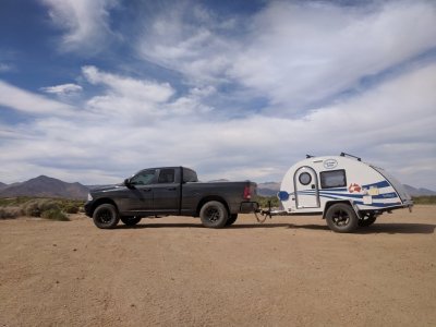

My situation is this - 2017 quad cab 4x4 - almost all of my needs are centered around pulling a travel trailer - but, I am also looking to raise the truck 2 to 2.5 inches ish for those times that we do get off road, (and put on some taller tires, thinking 285/65R20's on my stock wheels). We were in Moab a while back and were wishing for some extra clearance.
I'm leaning heavily to the Eibachs with their springs for the front - I know that availability is an issue right now but I can wait a bit.
The rear is where I'm uncertain, right now I have some TufTruck 2011 springs installed - and they ride perfect for my needs. Initially I was going to retain those and use some 2" spacers, but was advised against going with spacers - don't know if this is accurate advice or not.
Looking at a couple of different springs for the rear, TufTruck 1223's, Icon Springs, Possibly the Eibachs but I'm not sure the Eibachs would raise the back enough. I want to raise the back sufficiently in relation to whatever I raise the front, so that I'm not nose high when I'm towing. I pretty much keep 250-300 pounds of camping gear in the back of the truck at all times.
Rear shocks I'm thinking Icons.
