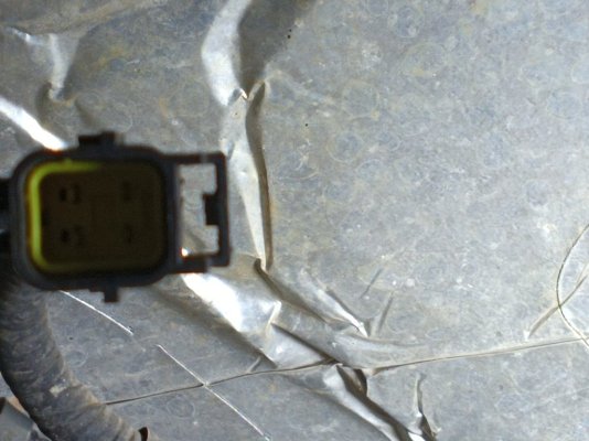

I’m trying to change the bank 1 sensor 1 (driver side upstream) and have pulled the front drive shaft but can not seem to unclip the electrical, I can barely get my fingers on it so that doesn’t help.
Could anyone tell me is it a push in style clip or a pry out style clip?

Its a push clip, If I remember correctly. Just swap it out with the rear O2 and see if the code follows before buying a new one. Also do a bench test with a torch and Voltmeter.

It has the safety lock on it and then it is a push clip.
So you move the safety clip up and then squeeze and it should pop out.
If it's been replaced before, the safety clip may be missing...

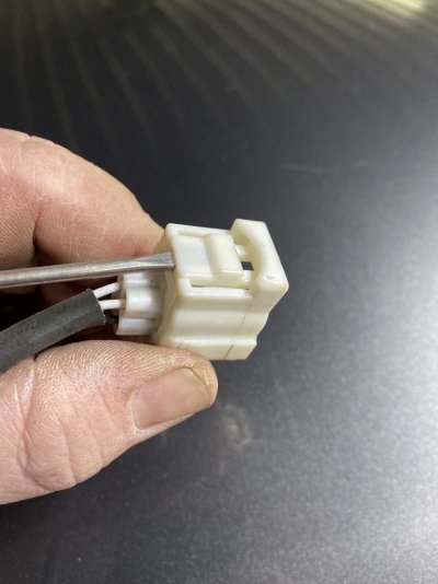

image.jpgThat’s the clip there, I was thinking to pry from back with a screw driver.. I’ll see if I can get at a safety clip.
Thanks

Well that sucked but it’s out. Seems like it’s just a push clip. Had to pop the connectors off of the mount and then I could just barely rotate it 90 deg and with my feet facing the back right tire I could just reach it around the transmission lines.
Probably would just take to dealer next time..
