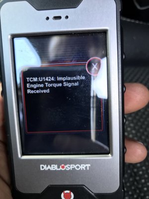

Anyone run into this code?

First time for me, stepped on it at 60mph and went limp until I restarted/cleared.

If I remember correctly, there is possibly a flash update available for the TCM that corrects this issue. I'm not 100% certain that it applies to your combination but it is worth a look.

Interesting, I do have a recent Greene Tune revision so I'll shoot the question over if this isn't an anomaly.
Did run in to a few cases on the Hellcat forums stating bad gas pulling too much timing and ironically filled up today. I was logging so we'll see what the data says but it happened instantly before even downshifting completely.

Just to follow up, there were no surprises checking logs with knock retard.
It happened again recently, it is due to being engaged in cruise control and then the instant pedal transition shocks the TPS/torque management.
