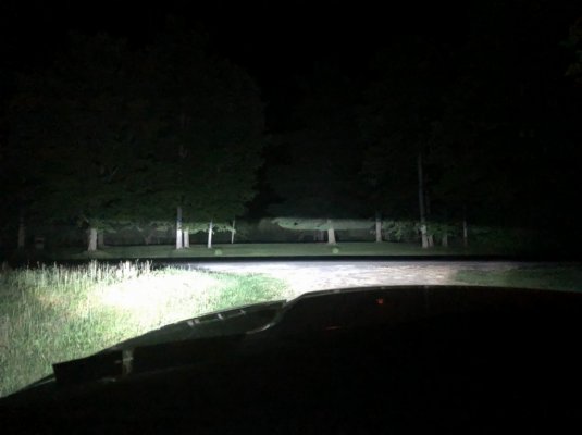

Here's a pic
Edit
From the front of my truck to the road is about 15', another ~20' of road and I'm sitting nose high

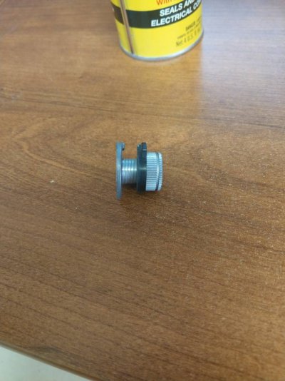

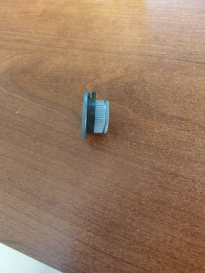

Well I figured it out but it's not exactly the issue I thought (but close). The series of washer-like thingamajiggers under the bottom screws were not seated properly causing the cutoffs to be staggered.
Good...
Not good...

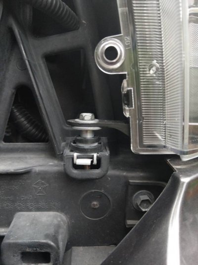

More information, this is actually another adjustment (see pictures). It can be screwed in and out to correct alignment issues. Sometimes, it gets unscrewed as you screw in the lower headlight bolt...

I didn't notice until I had a projector cutoff for reference. I believe the little plastic retainer on them breaks after a while and allows it to spin as you tighten the bolt down. Easy enough to correct though and it's nice there is another adjustment I suppose?
