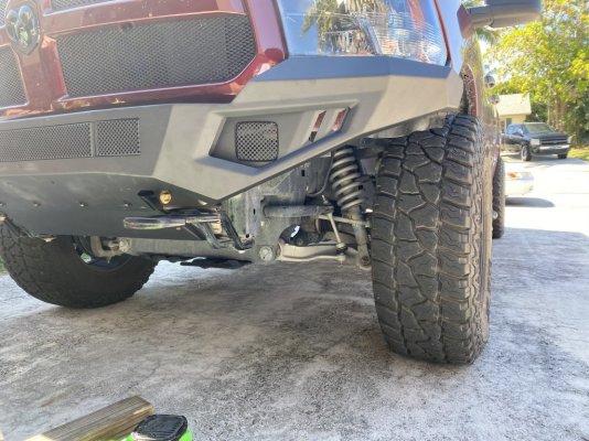

No issues on cv angle because it’s a leveling strut not a strut spacer. Been this way for a while including off-roading. No binding either. As stated it’s full lift is from struts using preload so none of the suspension can overextend like with strut spacers. Only reason I’m going back down in height is to get back some more down travel for off-roading. Still aligns perfectly as well.

Can't really see cv angles from that pic.
