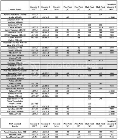

Hello, I was bored the other day while looking up trans. fluids and decided to make a chart for those whom always ask about which is best, has what, so on and so forth. The numbers are based off of that Brands' "Data Sheet" and/or MSDS and those Brands' without info. are due to either their inability to provide data publicly or is an in-house brand not providing documentation. If the following chart is too large I can easily switch it too a link (just thought seeing a chart up front is nice). Hope it helps someone out lol

Thanks, very cool.
