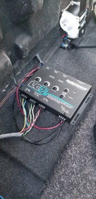

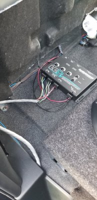

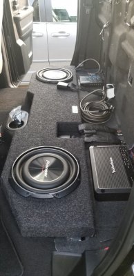

Alright guys here's an update. I plugged directly into the amp and all speakers except the dash worked. I was planning on running them from the HU so I didnt expect them to work anyways. I disconnected the battery for about an hour while I did some things around the house. Plugged it back up and nothing. So I ordered those AC-LGD so hopefully I get those soon. I appreciate all your Input as of now I'll keep you posted once everything is finally all said and done. Here are a few pics of what I'm working with.

Thanks for the pics. Aside from the resistor possibility, I'd not jump the rear to sub. Let the lc7 sum the channels and output the sub. Can't tell if you have your lc7 levels turned down or up. Im sure you adjusted that though while troubleshooting.

Okay I will do that for the sub. Yes I've played with the knobs to make sure they werent turned down. Do you think my dash speakers will work that I cut into the harness or will I have to run new speaker wire to them as well?

If you cut and spliced opposed to t tapping then no they won't work. What did you put in the doors again?

AC LGD might now work. Get 47 ohm 5 watt resistors and that should do the trick. Just went through this with a shop. The Audio Control items were removed and the resisors went in there place. Bam... audio was working.

Yeah I didnt think about that so I will fix that when I get the load resistor.. I went with Cerwin Vegas all around. I also have a Kicker 750.1 amp for the subs that I didnt put in yet.

Oh damn.. well I already purchased them so I'll try my luck and if not I'll go that route. Thanks for the tip.

So I fixed the issue and tapped into the line so now my front door and dash speakers work powered by the radio going through the Lc7 and amp. No audio out of my tears tho. I should be getting the LGD tomorrow
