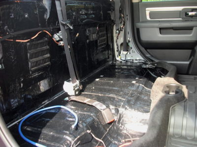

My amp rack is 1/2" composite. It's the same material you see for plastic deck boards. It's bonded to the wall with sub floor adhesive. It's stuck to dynamat so I could peel it off If I really tried, but it's on there good.

View attachment 127626 I know you're running similar set up to me amp wise. Dsr1 tucked in under the dash nicely. Can't seem to get a good picture, but here's the amp rack set up. Still have to get some ridgid felt to cover the few spots you can see wiring and dynamat, but it's almost done.

Yeah Im the same way. I currently just have my kicker 170 rms x 4 amp screwed to the sheetmetal behind the back seat. When i get time im going to use a 1/2" mdf board covered in black carpet, then screw that to the sheetmetal like you did.
Is your box a JL box, and shich model and size speakers are you running? Are you happy with how loud it is? Im now thinking about running one JL 10W6 under one side of teh rear seat.
It's a JL audio stealthbox. Has 2 10TW1 in it. Really good for everything but rap and plenty loud. Decent for rap, but it doesn't hit low like 12s do in a bigger box. As the only option I could find that let's me keep fold flat load floor (albeit with modifications required to make it work) it was the best for what I wanted.

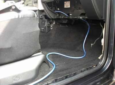

What route did you take with your power and signal cables
Looks like you had to get Power, speaker and RCA's to the front
Some one was saying you can't run power close to signal cables ?
Power up the drivers side. Rcas and speakers under the centre console and across the front edge of the seat tray then up the passenger side. I have dynapad under my carpet so the wires were easy to conceal.

Wow, then you had to come across the dash to the amp with the speakers and RCA's
I don't have RCA's but have the DSR1 extension cable

Finished up the sound dampening in the back, and got the power wire ran to the battery
In lieu of rigid felt, consider 1/2" Dynaliner. That will really help with ambient noise. The dynamat + dynaliner = goodness.
I already had dynamat on the back wall and dynapad on the whole floor. I got some auto carpet underlay and it did the job really well and on the cheap.
Yeah this is the route I went. The nice thing about the Dynaliner is the adhesive backing, unlike the pad (which is awesome stuff). The bad thing about Dynaliner (any Dynamat product for that matter).... $$$$$.

Yea that sound deadening was a PITA
Going to see how it sounds before I go any further with that , Hoping I am done :eek:
