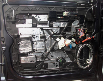

Last Door, Thank God
It is not the best job, but better than nothing

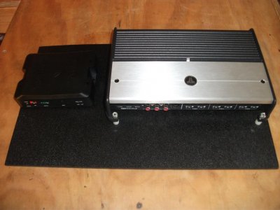

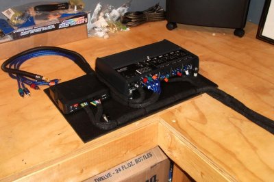

Mounting the Amp and DSR1 on a piece of 1/4" ABS. Bolting the amp down with Nylox nuts and just going to Velcro the DSR1 down so I can remove it easily for firmware updates
Finished the wiring as far as I can go until I get the seats out and can mount it in the truck, it is going under the drivers side rear seat

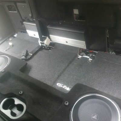

IMG_20180506_143908.jpg I know you're running similar set up to me amp wise. Dsr1 tucked in under the dash nicely. Can't seem to get a good picture, but here's the amp rack set up. Still have to get some ridgid felt to cover the few spots you can see wiring and dynamat, but it's almost done.

Thanks. A few more of the tedious details and I'll be happy. I know it's behind the seat and I'll never see it, but I'll know it's not as good as it could be and it'll bug me if I don't clean it up.

Yeah Im the same way. I currently just have my kicker 170 rms x 4 amp screwed to the sheetmetal behind the back seat. When i get time im going to use a 1/2" mdf board covered in black carpet, then screw that to the sheetmetal like you did.
Is your box a JL box, and shich model and size speakers are you running? Are you happy with how loud it is? Im now thinking about running one JL 10W6 under one side of teh rear seat.
