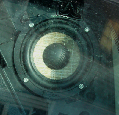

limit the beer while tuning...alcohol tends to give you a false sense of sweet in more ways than one.
I would also try to get that midrange mounted with four points of contact if possible...i know its a tough angle with limited work space, but that's a nice speaker and you want to set it up for as much success as possible. Maybe add some pillow stuffing or CCF under the speaker to tame back waves too

I will see if I can cut out some ABS mounts is the only way I can think of .... what is CCF ?
Tough with out a table router, but doable

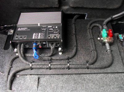

Biggest thing I did wrong was set the crossover on the amp too high. This morning I turned it on. Not way up though since some people are hung over and still sleeping. Can't even tell the diference between rear speakers on and off so the gap in frequency I had seems to be gone. The midbass really woke up after a bunch of high volume run in hours. I'd bet you get a bit of a noticeabe improvement once you get those focals broken in. Not sure exactly what all I changed as my bravery and let's see what this does level were fairly high last night. Heard a couple pops out of the midbass when at full volume so I had to turn them down slightly as I have more amp than speaker. Can go right to 37 and it still sounds good. At least what I can still hear! Not sure you'll stay with the factory sub enclosure, but with the gear you have you might be happy regardless. My JL 10's are sounding better now too as the buzzing the subs were doing at low frequency seems to have worked it's way out. System was full volume for 3 hours and the amps were just a bit warm. Cooling or power supplies have come a long way.

Once I get my amp back I will check where the factory radio with puts out distortion with the dd1 and let every one know

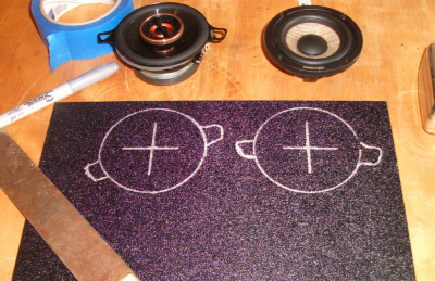

the 2 7/8: hole saw is out for delivery. I will be ready when it gets here ........... lol
Was able to secure some 1/2" CCF locally :waytogo:
Glad I am changing it, was not real happy with the two bolts and fender washer approach, just lazy

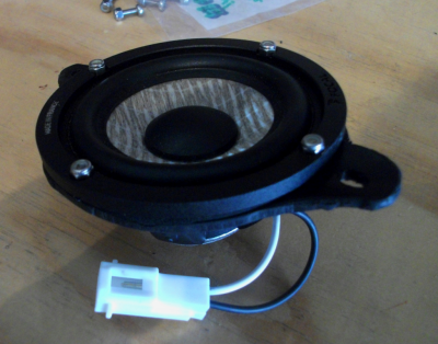

All done, Worked out pretty well other than my jig saw cut out just melt right back together
Had to cut a little and hen go through it with a utility knife
