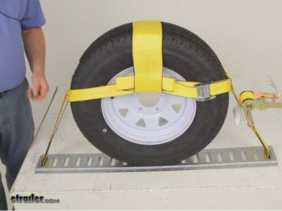

We used axle straps with standard 2in ratchet straps. Always was intrigued by the ones that go on a rail system and over the tire but never used them.
Edit: adding pic of the rail system I mentioned.

Yeah that track system looks interesting. My concern is that most enclosed trailers only have 4 tie down mounts and with smaller unibody cars it seems you are limited on tie down option. Maybe that track system between the factory mounts
