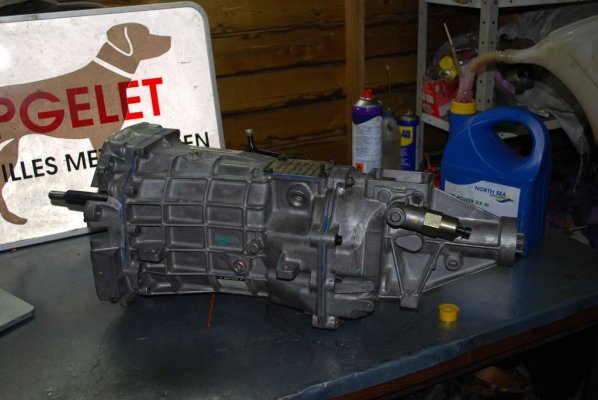

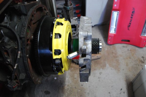

Testfitting on a spare hemi block, I chose to use a bellhousing designed for the challenger, therefore it is designed for a TR6060/T56 magnum, therefore for tit to work with my T56 I needed a 5mm spacer.

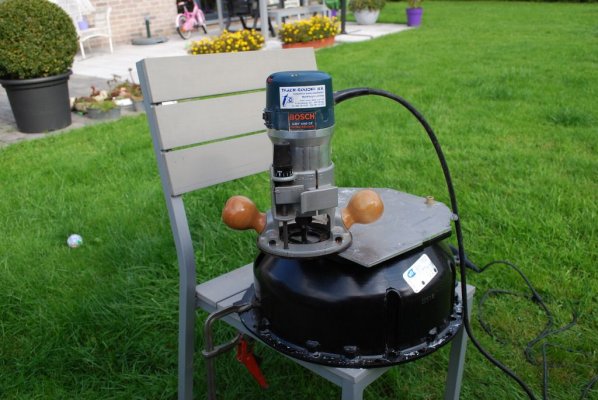

'Machining' the spacer out of 5mm aluminium plate:
More testfitting

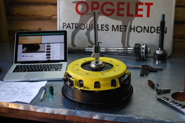

Measuring slave cylinder travel/engagement
Rebuilt transmission with some minor upgrades, brass fork pads, brass shifter cup, carbon syncro's, billet syncro keys.

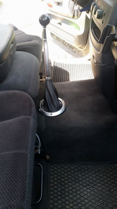

Couldn't find the SRT10 manual shifter interior so just put the shifter on the floor. Button is for the reverse solenoid.
