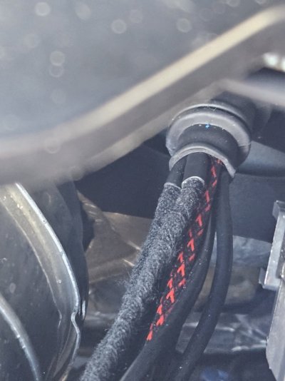

Finally got my 10 AWG positive (to the battery, via a 50 amp fuse) run through the firewall. Now let the fun begin in the under the dash wiring to the CB / GMRS radios, Dash Cam and stuff!
I used the Clutch Delete Plate to try to professionally run a wire bundle through the firewall, and followed the advice on this other Thread: https://www.ramforum.com/threads/ho...-plate-for-running-wires-into-the-cab.117923/

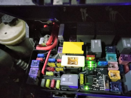

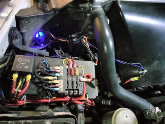

Your best bet might be to add a power relay off of some feature that your truck doesn't have like the sunroof or heated seats, then to use the battery power that is now switched off of the relay. However, a word of advice, if you plan to have more additions down the road, go ahead and put in a fuse box that takes the battery power that's off of the relay to power the fuse box.
On mine, I needed 60 ampereems to run dual electric fans when I got rid of the power and fuel gobbling clutch fan. I also had some extra LED lights that I wanted to power, so I added the duse box on top of the existing fuse box lid.
