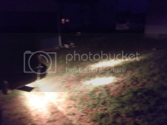

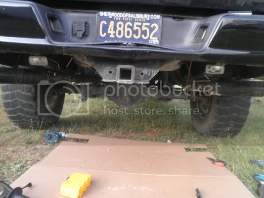

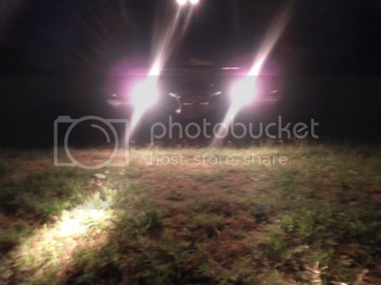

I ran a set of cheap Autozone foglights mounted on the sides of my hitch. They worked wonderfully for 3+ years.
I ran the $20 specials incase I backed them into a rock or drug them while wheeling. Just replace em.

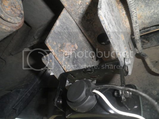

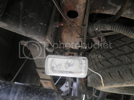

I got a 1/4" plate 90° bend, bolted it solid to the hitch mount (similar location) and then bolted the light to the bracket.
I've always gone a touch on the overkill side.
