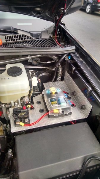

Also looking to add a aux fuse panel if needed with a plate and dedicated breaker like picture below.

For the fuse box I don’t mine using either boxes. One is just a lot easier to add to later.
kinda was looking to see if anyone had made a bracket for one that fits in the engine apartment above the current fuse panel.

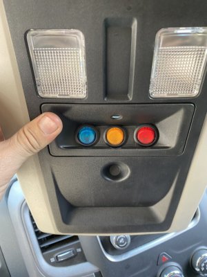

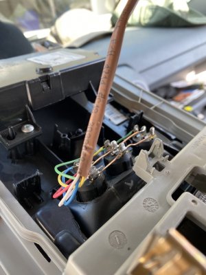

Here’s the set up I ran, my overhead console didn’t have a few switches, so I pulled it apart and added 3 light up rockers and ran it through the boot for the main harness there’s a little nub below the you can cut the tip and fit wiring and run it along the side of the engine bay to pop up next to the battery. Hope this helps!
