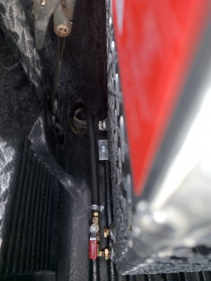

I agree there is no need to add additional venting to the OEM tank. I cut the OEM vent line, put in a tee and vented the Aux tank's vent line to the tee. Now any fumes or vapors get routed into the OEM vent system.

I don't see hold down bolts in one picture, I presume that is before you finished. I would have a problem with the tank moving and cutting the fitting or hose off.
I can see problems with over filling the main tank, would yo not have gas blocking/ filling up the vent?

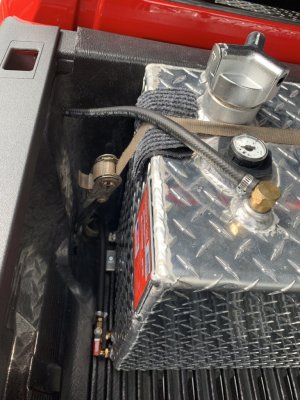

08CF62C6-7A92-421B-BE32-ED79A54C42AD.png I have 3 mounting bolts, 1 per tab. The ratchet strap shouldn't be needed but it can't hurt.

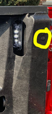

The trucks bed has the OEM spray on bedliner, but I already had the plastic bed liner in my back yard from my 2010 Dually that I no longer had. Same exact liner, even had matching holes near tailgate to secure it. I did have to cut holes for the LED bed lights. A slide in liner will better stand up to dropping of heavy items than a spray on liner. Best of both worlds.
Truck bed and liner had matching holes for plastic rivet!!!

I as just wondering if the liner will stand the weight of a full tank on it with out crushing the ribs?
You would have a bit more room for the fittings , if you had got a shut off value with a male end on it , than you don't need the coupler, harder to find , but they make them. My truck has the spray in liner, few years ago I had a '95 and put in a liner, and the liner rubbed all the paint off the floor

If my math is correct, I figure the weight of a full tank of gas plus the weight of the tank itself is about 500 lbs. Tank dimensions are 56" x 13". Ribs and valleys of liner are roughly 1/2" each. Pressure of tank on liner is about 5 1/2 lbs/sq. in. I doubt that is anything to worry about. I certainly won't.

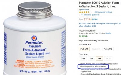

I took the advice and used a pipe thread compound that is impervious to gasoline and it's also aviation approved for those times when I feel like getting some air in my 7500/8000 lb. truck!
I took my tank to a radiator repair shop and had them weld an extra **** where I wanted it. I didn't know if the "diamond" would interfere with the placement of the **** so I marked two locations. They were confused so they welded 2 bungs where marked. No harm, no foul!
All is well, no leaks. Works like a charm. Doesn't overfill the OEM tank. Doesn't overflow the OEM fill tube. It simple works.
I did add another ground strap from a tank mounting bolt to the factory ground bolt. Likely not needed as the 3 mounting bolts already provide a ground. But it can't hurt. Pipe dope.jpg IMG_2891.jpg
