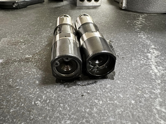

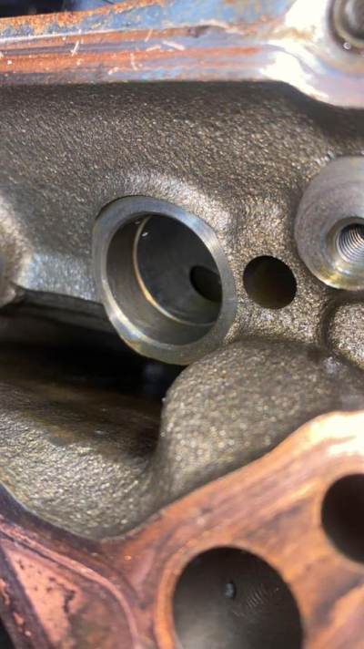

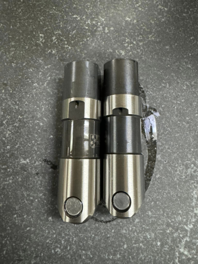

Johnson Lifters
Gen3 Hemi PSA:
There is a counterbore at the top of SOME engine blocks, that caused an issue with our original design. This was brought to our attention a few years ago, and I changed the body to accommodate. First popped up on 6.2’s, then eventually 5.7’s and 6.4’s. I don’t necessarily understand why they did this…but that’s neither here nor there.
If you have one of these engine blocks, be sure you are using our latest design. If you use the old design you will have low oil pressure.
We’ve phased the old body out years ago, but thousands of sets had been sold prior to the change. If you wind up with the old design from one of our distributors, contact us and we’ll swap it out free of charge.
The pictures below show the lifter bore counterbore, as well as both old and new designs. The new design is on the right, with the lower seat height and oil feed oil detail. The latest design will also require a longer pushrod
