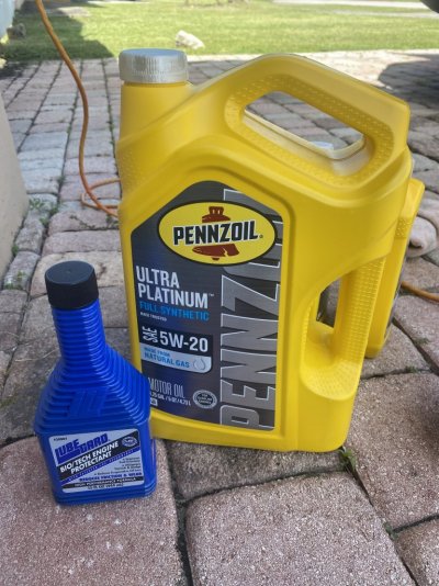

PUP 5w30 cSt is 10.3 and 5w20 operates at 8.8. So moving to 5w30 wont give you any too thick oil type symptoms, it will just give you a little more protection.
