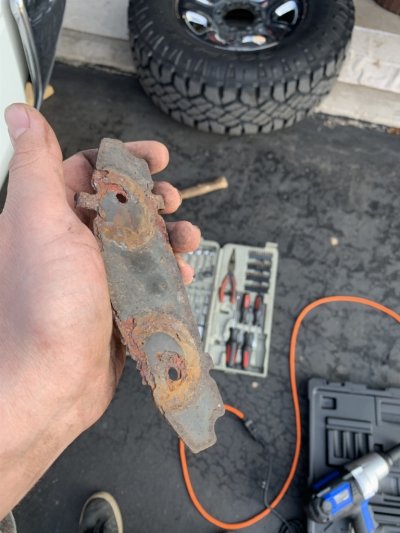

Guessing I’m adding brakes to my list [emoji849]
Left rear hung up. And this was in the driveway when I left

36k. Wasn’t banking on pads falling apart. Thanks New York salt f33064bb1e63cb8b186c2eafeb98cc69.jpg
