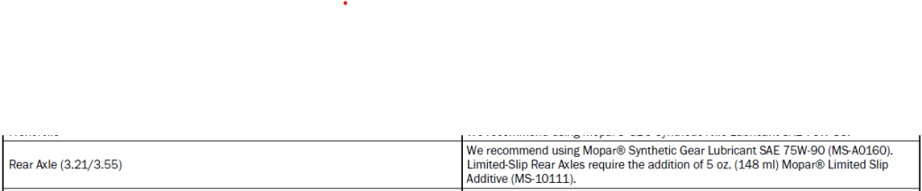

2017 Ram decided 75W-90 was good enough.
That's the same year they removed the 5W-30 from the engines. They used to have this note in the big 700 page owners manuals and the online manual up till 2017.
