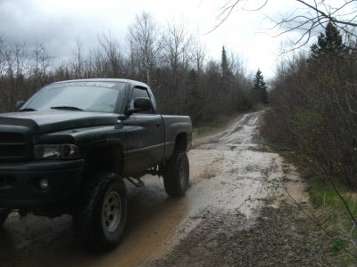

thanks guys for the info the axle i dont have they probly would be off a older dodge 1997 around that year and ill post some more pics of my truck as soon as i figure out how to post them

Nice rig! and by the name i would guess you have a w900l got any pics?
