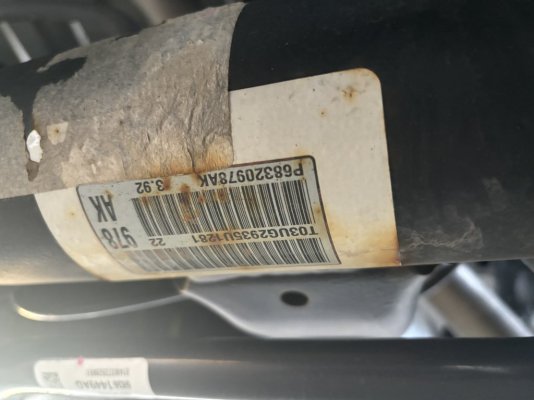

That’s pretty much where I’m sitting but window sticker shows 3.21 gear! Now I’m wondering if there was a mistake made here at the factory!!??
Bottom side the drivers side rear axle tube should have a sticker with the diffs part number and in smaller numbers it should also have the gear ratio printed on it.

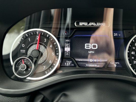

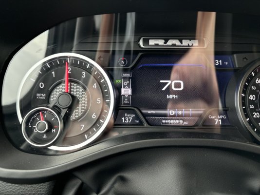

2026 hemi with 3.92 gears, stock tires.
In 8th gear its about 2000 rpm at 70, and about 2200 at 80.
Mine reads exactly the same with 3.92 gears - 2000 rpm’s at 70mph. Even if the factory slipped 3.92 gears into the OP’s truck by mistake it wouldn’t be taching as high as he is reporting - unless he has some undersized tires on it.

Out of curiosity, crawl under the rear axle and see what your data tag shows for gearing.
If it is indeed 3.21 (and the actual gearing is) and you are having those rpm’s at those speeds, your torque converter must be slipping.

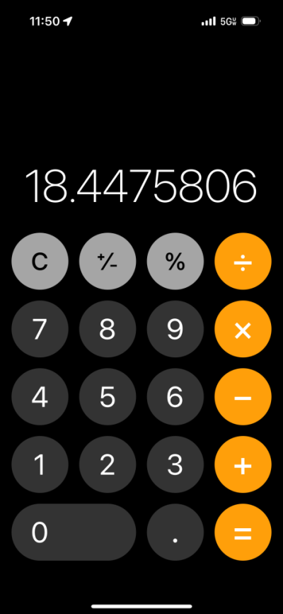

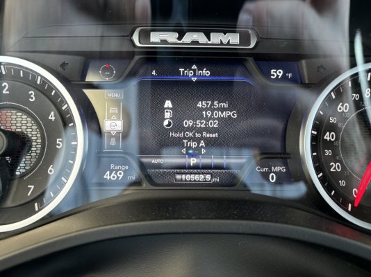

Welp, burned up a full tank of gas driving my normal routes (northern mi 55mph roads, minimal traffic lights, some hills, no mountains etc.), but drove like grandma going to church the entire time. It was terrible lol!
Mustered out 18.4 mpg (hand calculated, the dash showed 19). 2026 hemi, 3.92 gears with off road package. All stock. 10,600 miles.
Im not sure how i could possibly get any better than that with this truck. Not ******** about it, but the ‘17 without etorque (3.21 gears) i had did better.
