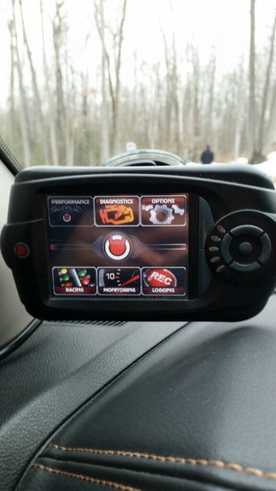

Tuning wise they're exactly the same. One won't give you more power than another. The intune just plugs in and you unplug it when you've installed the tune. The Trinity can be left on all the time to be used to monitor the engine, race mode, etc.
I have the Trinity because personally I like to have the ability to monitor the engine for knock or what have you. Plus it makes it easy to see your 0-60 numbers.
Size on dash (not in the way at all)
Main screen
Knock monitoring screen
