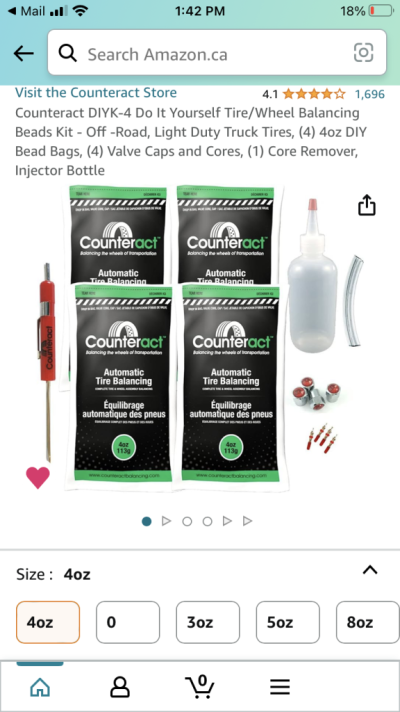

I've run balance beads for a few years and they work for my truck. I purchased a set of tires that the dealer had difficulty balancing. After multiple trips to the shop, I ordered the beads displayed in the picture. They solved the balance problem immediately. I have also used them on a set of classic wire wheels that were never able to be balanced using the normal machines. The balance beads work, in my opinion.
