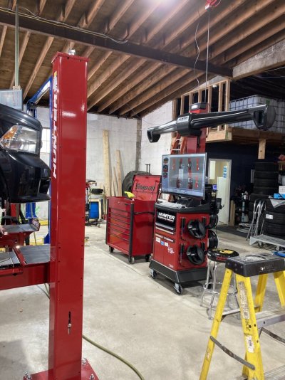

yeah, it still runs the code that came up on my obd reader is I believe is p2098 and I read what it was an there is no hesitating in ideal, and I was planning on taking it to another shop I went and picked it up already. An thanks again for that site incase I do or need to go that route.
I can highly recommend AK_trucks_pa in Marcus Hook PA.
It’s Quick_Shifter’s shop, a member on this forum, and the only mechanic I trust with my truck.
I live in VA, about 2 1/2 hours away, posted this many times but I would happily drive twice as far to get to his shop.
