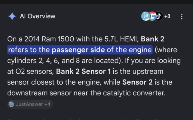

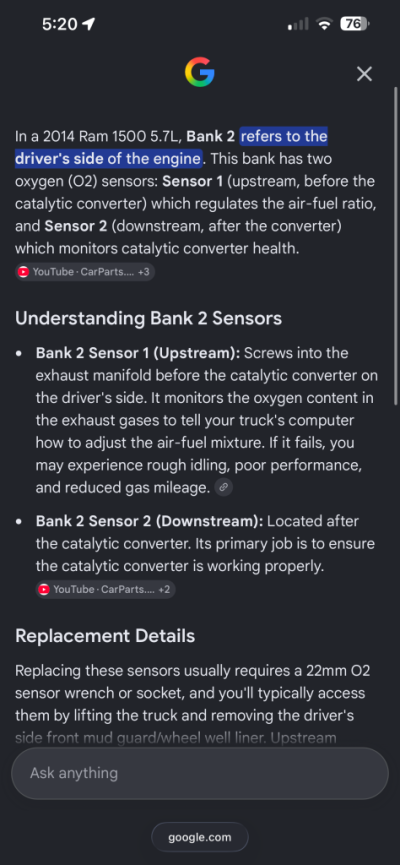

the one code that shows is P2098 fuel bank 2 lean condition. An I know there are a few reasons why this would happen. Mainly too much air getting in. From what I read an i appreciate all of your guy's information an suggestions.
