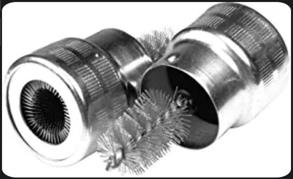

After the first signs of any starting or battery-related issues, I'd suggest cleaning the battery posts & clamps and adding a light coating of dielectric grease. And then a cycle with a low-current battery rejuvenator or smart charger, is cheaper than driving these days.
Pick up one of these at your local auto parts store or from Amazon. I try to do this annually at a minimum.
