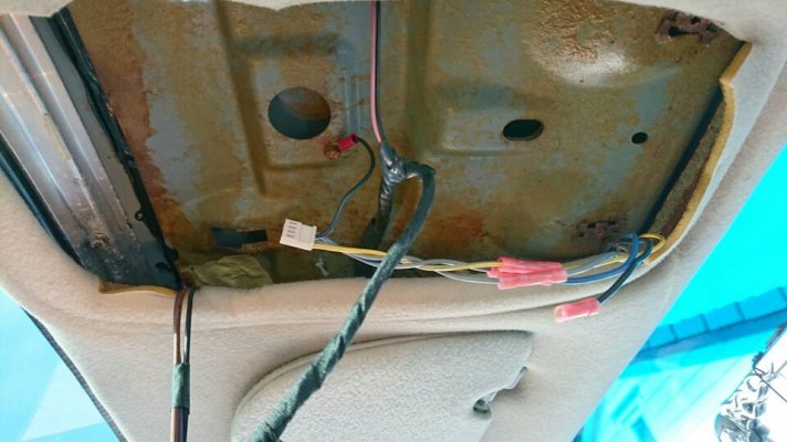

Found this cable ending up in the over head lights unit. Dont know what its for.. Anyone?
And also the lights inside the cabin is always on.. Anyone see any faults?

It appears that the previous owner had something up there, follow it down and see where it goes.

Your truck has an aftermarket sunroof? Did you find out where those connectors went? I bet it has something to do with that sunroof up there!
