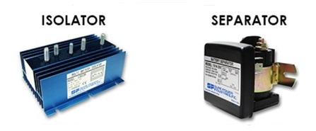

My Ram 3500 5.9 loses charge after 3 days of inactivity while my camper is plugged in. I’m pretty sure there is already a battery isolator installed but I have read something about a .5 volt leak from the 6 pin plug is normal. Is that enough to cause an issue of a dead battery after 3 days? Also is the picture attached the isolator?A957DF18-79DF-4E01-94B6-9A6CDBA0AE27.jpeg

What you pictured appears to be a solenoid. They are not the same. Think of a battery isolator as a huge diode that only lets juice flow one way (LEDs work like that which are just Light Emitting Diodes). Solenoids are heavy duty switches that are turned on and off by smaller amounts of amperage current. Lots of people use battery isolators when they run more than one battery in their trucks that aren't diesel. Repeat-are not diesel. When I tow my trailer I do not have a battery isolator in line because I don't plan on leaving my truck connected when not in tow. You have a phantom drain in your camper that you need to track down. The 6 pin plug by itself is not the problem-it's what is plugged into it-the camper. Good luck,

Thank you for the information.
I will look for short, I kind of have an idea where it might be.
