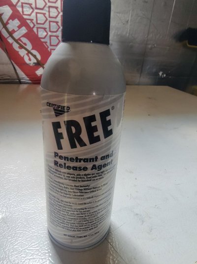

I'll check tomorrow, should be in my garage somewhere. I know he said it wasn't sold in stores. Seems to work pretty good. I'll drop a picture here when I find it. Hoping to start ripping the truck apart tomorrow. Need to see if I have a 4x4 laying around somewhere so I can jack the whole front end and place jack stands. I have a crappy hydraulic floor jack (works okay just doesn't have super high lifting range). Can't get on center frame and get both tires off the ground. Real world problems. Just sucks if if have to do one side at a time.

Does the can say anything about what the fluid consists of?
Jan 17, 2016
23,714
54,457
14 Sport
I'd have to check, I don't remember seeing it on there.
Found some info on it,sounds alot like acetone/transmission fluid with a propane carrier to cool things down in a hurry.
I could see it really working good on a rusted bolt that's hot

Guy gave my son in law a few cans to try out and he gave me one. He usually uses acetone and trans fluid for stuck rusted bolts as well. He works on paving equipment and dump trucks for his family's business so I can imagine how bad it is getting some of those bolts out. If I don't end up getting a good seal after I'm over COVID I'm taking my truck to his shop so we can get this figured out. He surprisingly does not have a lift there, but plenty of jacks and stands and every tool imaginable.
