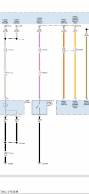

Got the wiring diagram from the dealer today and looks like the 2018 C6 pin 26 (Cargo lamp switch signal on circuit L26) is the equivalent to my 2019’s C7 pin 16. And then the 2018 C1 pin 5 (Cargo lamp driver on circuit L19) is the equivalent to my 2019’s C3 pin 17. Can anyone look at the snapshots of the wiring attached and confirm that I’m not just looking at this completely wrong?

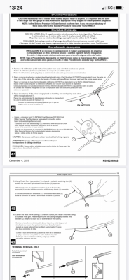

Hey looks like I’m in the same boat as y’all trying to figure this out.
So it sounds like the latest set of drawings (K6862869AB) are what to go by? Tan/white to C3 Pin 17 under the PDC, green/white to C7 Pin 16 under dash.
I think the newest kit comes with 2 tan/white wires, one to reach under the dash on older models/1500 classic, one to reach under the PDC. Only one gets used in an installation. The kit I received is older and doesn’t have two tan/white wires.
The issue I’ve run into is there is already a Tan/white wire in C3 Pin 17. Do I need to splice the new tan/white to it?
My truck is a 2019 2500 Power Wagon. Has the CHMSL camera and surround view if that matters.
thanks.

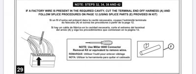

Upon further review of the instructions, it says to splice the wire if an existing wire is already occupying that pin on the connector.
The fact it’s a tan/white wire already occupying the pin location makes me confident it’s the correct wire to splice. The kit comes with a fancy crimp to use for a splice, but I don’t have the fancy tool to crimp it with. I think I will use a vampire tap and confirm it works once the dealer activates the kit, and then maybe I’ll resplice with solder.

I didn’t use the fancy crimp. I peeled back some of the wire’s insulation and soldered the wires together. The. I had to bring back to the dealership and have it flashed.
