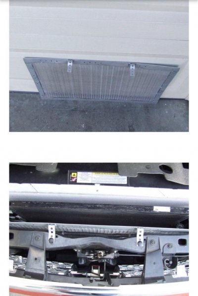

Looking for a "behind the grille bug screen" for a 2016 Ram 1500. Have looked on Amazon, Google, Auto Anything, and e-bay and found nothing acceptable. Does anyone have one or a source or have you made your own?? Was thinking of some window screen and then installing a couple of grommets and using zip ties(Kinda shade tree)LOL

I used to make one that fit the 1500's with electric steering Jay. But I gave my pattern to a welder as he was going to make them ,but when he moved he lost the pattern,aarrgghh,lol. If you look close at the bottom of the rad support there's a couple holes that are drilled and tapped for if I remember right 8mmX 1.25 bolts. I used those holes and the couple holes on the top of the rad support to hold a rectangle made out of 1/8" X 1/2" flat bar,that I welded expanded mesh to,then wrapped it with screen door screen. I made 5 ended up giving 2 away/keeping one for myself and selling 2 for the price of materials,then gave the pattern away,lol. I'm having a hell'va time with facebook these days,can't get into any of the good sites unless i'm tagged. If you tag me I should see it,and I can work on seeing if I can get sort of a pic of it for you.I'll pop the top plastic cover off and get a pic from the top,but i'm not pulling the grill for the bottom view,lol

On my '05 when I replaced the grill I got me some vinyl screening and rubber cemented it to the back side so that it's stretched taut. It's been in there for about 8 months now and no damage yet and it's easy to wash off with a water hose. It won't stop a rock, but it keeps the bugs from plugging up the radiators and when it does wear out I can cut me another piece, pop out the grill, replace, and pop the grill back in. A couple bucks and a couple hours or cheap and cheerful as my mum in-law likes to say.

When I buy a new (to me) vehicle, I go to Lowe's and get some nylon window screen. I attach it to the top and sides as close to the grill as possible. I leave the bottom loose. I did this in 2002 to my DD and I pull the belly pan off once a year to change the oil. Normally a handful of bug parts. Rad. & A/c fins clean and straight. I have done it this was ever since. Nick
