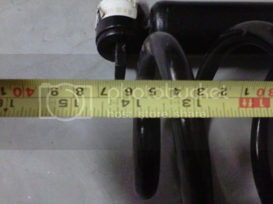

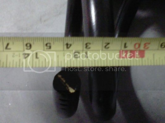

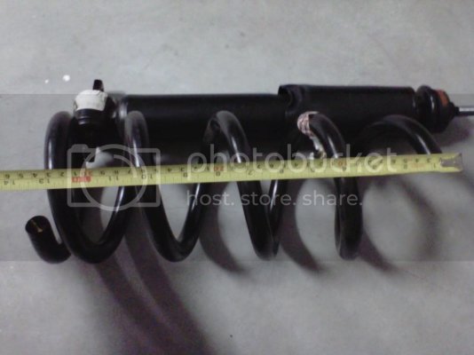

Here you go Big Boi...
My cut rear springs came in at: 14"... These springs were giving me a ride height at 36" from floor to center of rear fender lip.
The fronts are the ones that I cut too much off. These came in at: 13.5"... This dropped the front height down to just under 34" when they were in. It seems that once they get cut down to this length, the spring rates change dramatically.
Awesome, awesome, awesome! This will help me out big time! Thx again :happy107:
