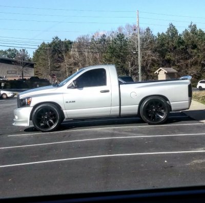

Heres the truck.
I can fit 3 fingers in the rear.
And exactly 5 fingers in the front.
Maybe since i dont have the hemi..theres not as much weight up front?
Ima give it a few more days....and im gonna get the adjusted/cut to make it level

That's definitely not level.

Air bags for the rear -which will also help with any kind of load you put in the bed, and level it. ...I'd tell those springs their going to be cut if they don't settle down!!

You should be able to see and for sure measure a 2.0" drop in the front. Most of the 1.0" lowering kits still make a noticeable difference in the front.
Did you use a complete kit from Belltech with lowering springs, lowering shackles and a flip kit with their supplied shocks/coilovers?

Heres a Feb 4, 2020 progress pic!
This was done almost a year ago but as yall can see i was busy. The shop heated the front springs to lower the front.
