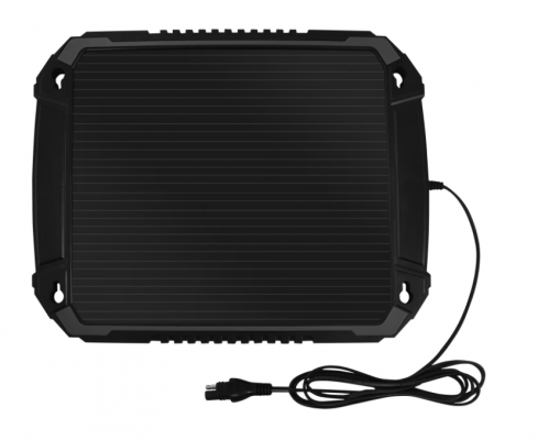

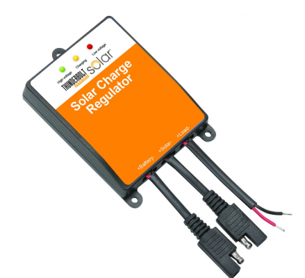

After almost 4 yrs, had the batteries go wonky. For the cold here I switched over to AGM style batteries (walmart everstart $360 for both). Though most times it is a daily driver, when it goes below freezing, I put it on a tender.
Over the last week we had 50+mph winds and <20°, and it stunk hooking up the tender, soooooooooo
Shortly I am going with the setup I have for the camper.
A 10w (almost 1 amp) solar panel, around $60 Coleman from cabalas
and a HF regulator, around $20, regulates 14-10vdc. I don't hook up the "load", so it will just shut down the charging when the battery gets to 14v. The garage light at night has the panel putting out just a hair under 12v.
The regulator and and an extension cord ($20 amazon) to run into the cab for the panel which gets stored in the pocket behind the drivers seat when not in use.
For $100, can have a fool proof system that
