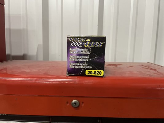

Stay away from FRAM. Working on cars and trucks for 50 years and had only one oil filter failure. In my own car. Called FRAM and they asked for the filter to be returned to them for inspection. Never heard back. In my opinion Royal Purple is the best on the market.

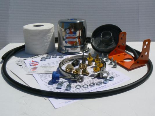

Now hey .....I've heard great things about *this* system, for the ultimate filtration. The upside is it saves that annoying trip to the parts store when you could be drinking beer on a Sat morning. The downside is you might get chased with a roller pin when your significant other discovers you used up the last roll ;). Give it a shot and let us know how it 'goes':
